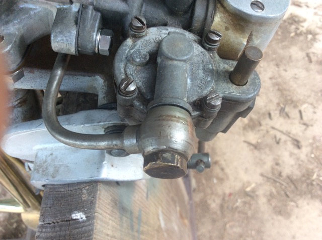

Should this fuel fitting have O-rings? It looks like they could be used or a gasket possibly.
O-rings would probably be crushed out of place. Fiber washers were used at each end of that "banjo fitting".
Tom
Thanks Tom ! I will have to try and find some.
I’ve seen them with copper washers. Should be able to get either of them get them at a hardware store.
