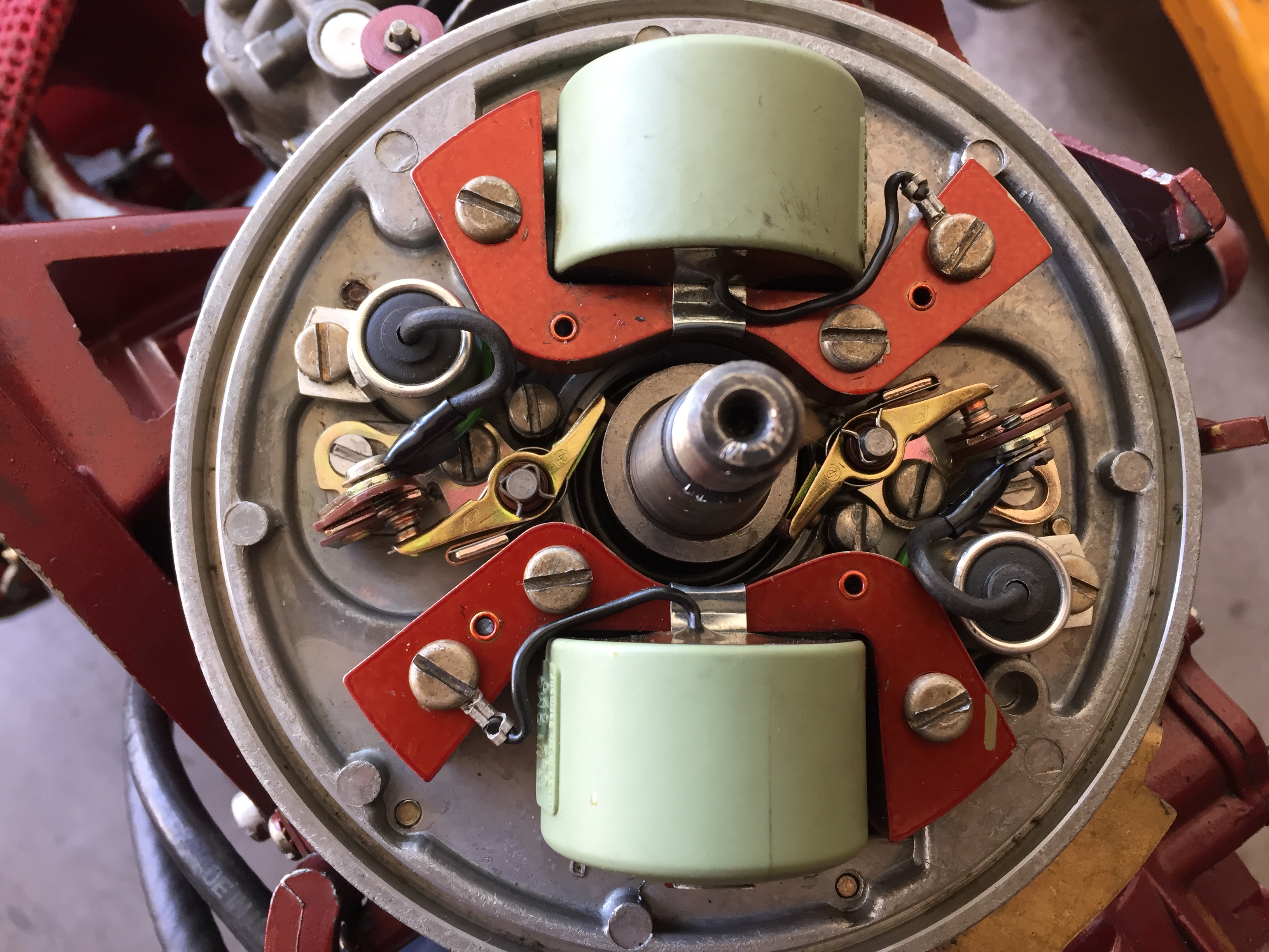

      In going through the magneto for my FD-11, I installed a new oiler wick in the oiler wick holder. What kind of oil do i need to drip it onto it? Assuming pretty much anything will work? How much? A few small drops onto a new wick or should I really soak it?
      Thanks!
      Scott

              The ground lead on that one coil is going to rub through on the flywheel hub. Maybe the other one also. Bend them back against the coils.

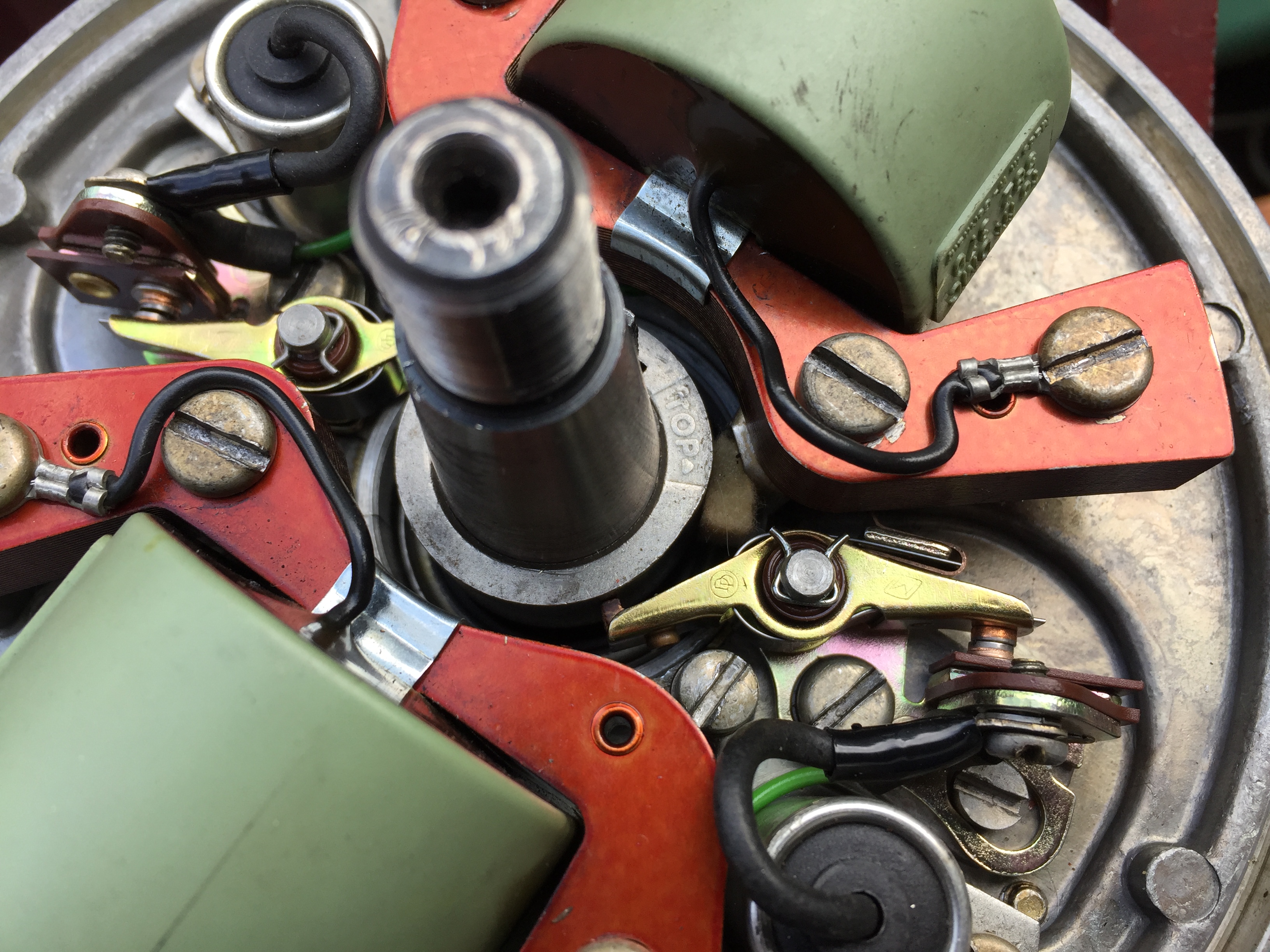

                opposedtwin
                  Better?
                  #60981
                  chris-p
                    Looks good!
