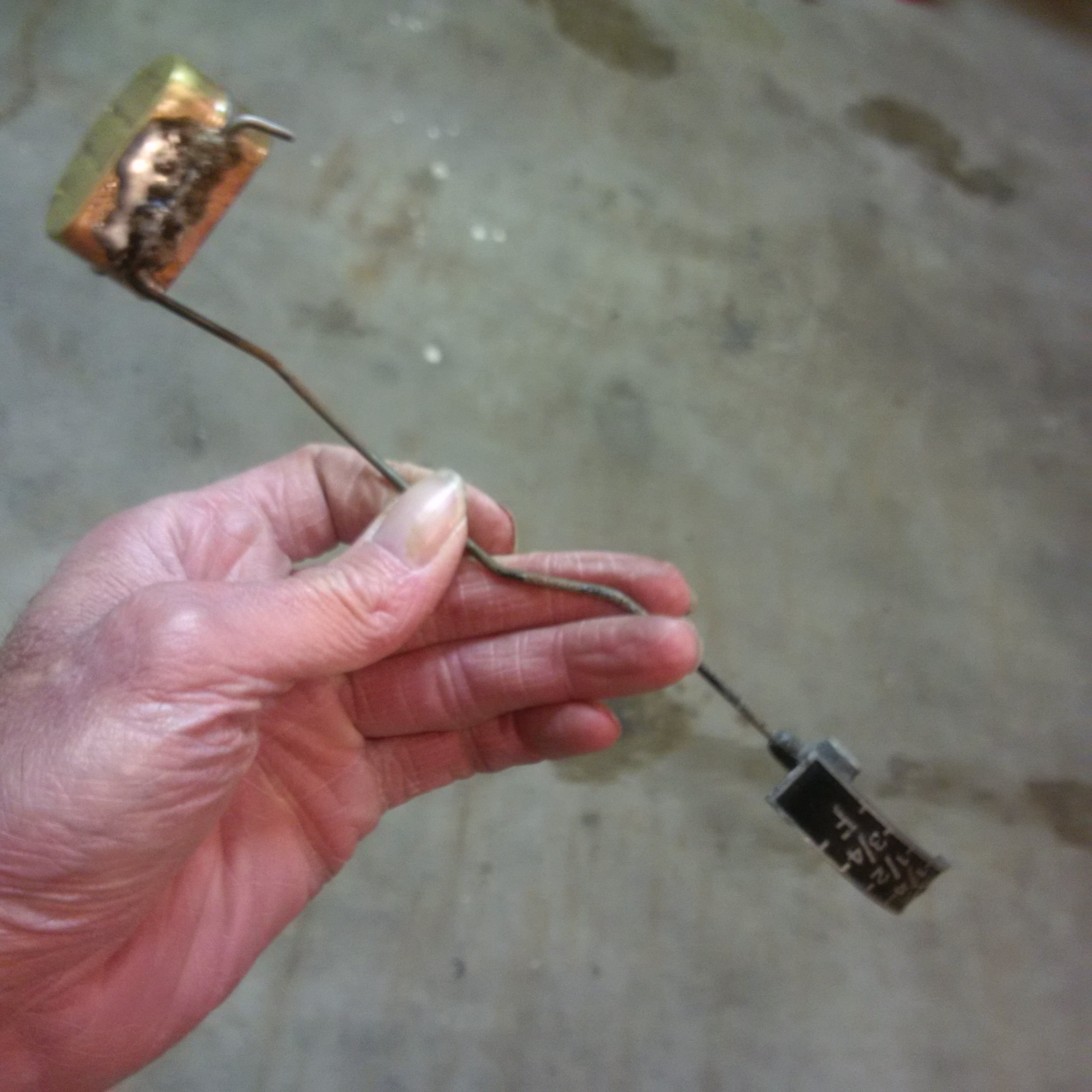

            #67010
            twostroke
              Holley float p/n 116-4 with the bracket removed. Dunno’ why it won’t work….
              My phone takes rotten pictures, but I’m too lazy to get out my camera……
              Jim
