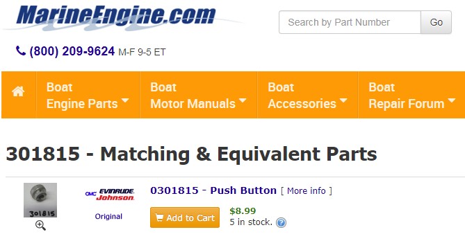

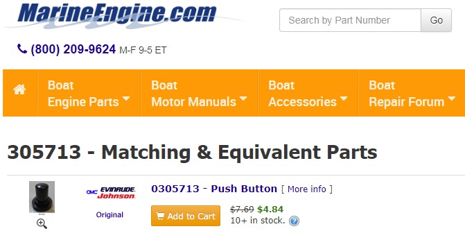

          I think I’m more worried about breaking the fuel fitting than anything. It looks like the tank itself just has a bunch of screws. I didn’t notice before but the primer button is broken off, does anyone sell replacements?
          #77200
          Steve D

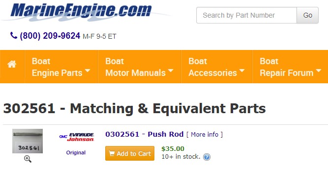

            You could place a Wanted to Buy ad for the push button parts and there are a few guys have rebuild kits:
            http://www.marineengine.com/newparts/pa … num=301815
            http://www.marineengine.com/newparts/pa … num=302561
            http://www.marineengine.com/newparts/pa … num=305713

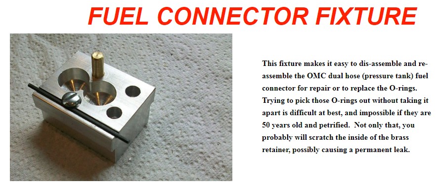

            http://www.franksoutboardtools.com/fuel … xture.html
            #77203
            elgin2
              That fuel connecter fixture is worth it`s weight in gold.
