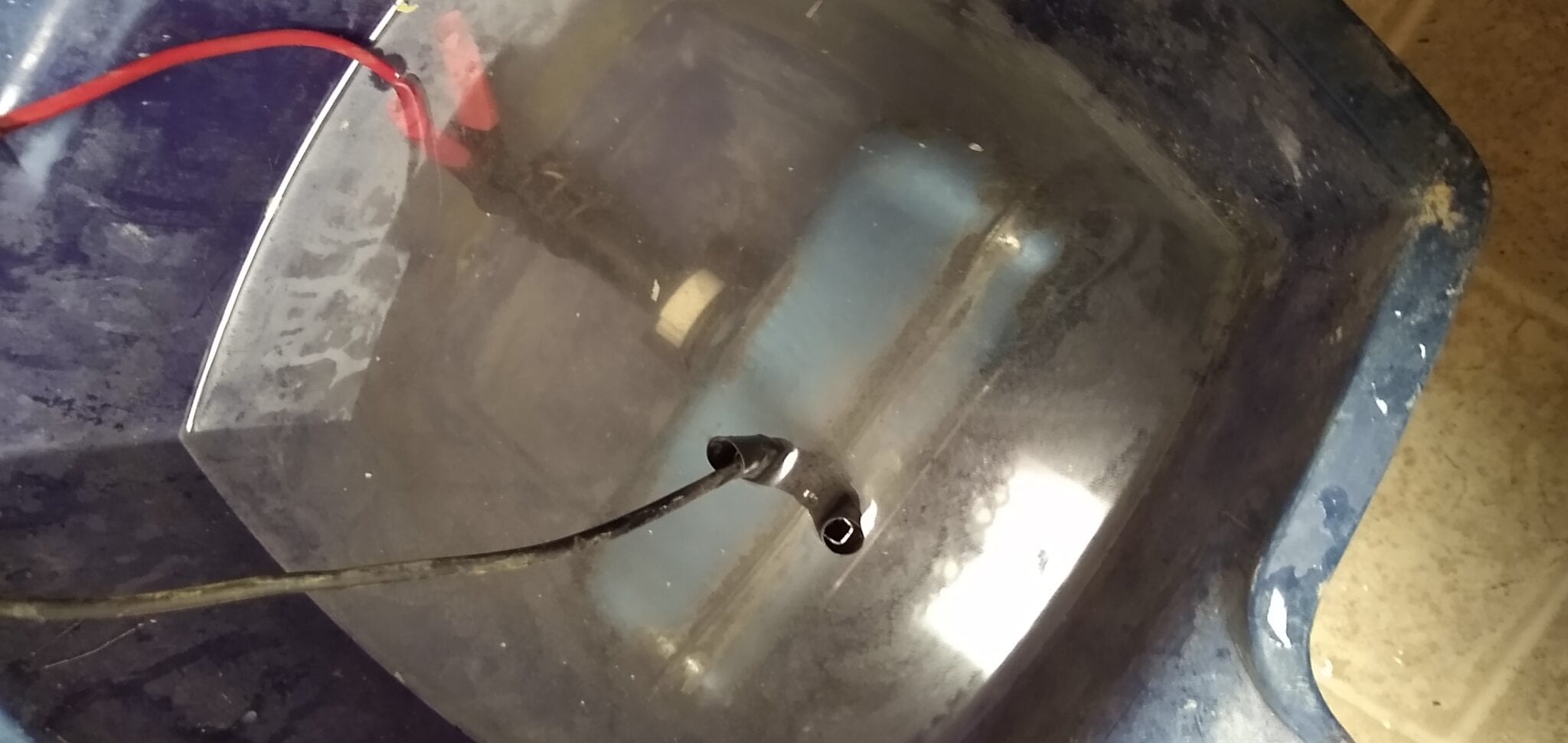

        aquasonic
          I put PVC pipe around the iron pipe to insulate it. Iron pipe is both inside and outside.
          IMG_20210307_222118178
          • This reply was modified 4 years, 9 months ago by Mumbles.
          I’m not sure that this electrolysis setup is correct. With the tank immersed in the electrolyte, the current from the exposed and submerged positive charger clamp is not insulated at all. Your steel tank may be acting as a sacrificial anode.
          Improvise-Adapt-Overcome
          #233825
          Timothy McDonald
            I agree. This setup I stopped using and began only filling the tank with solution. I really didn’t see any difference. Either way, when the gas tank is full of holes, such as the Neptune tank, it is not possible to only fill the tank with water/solution since it just leaks out. I did try this, putting only half the tank in solution and the negative clamp outside the solution. Raises the question ….if one clamp is to be submerged, which clamp should it be?
