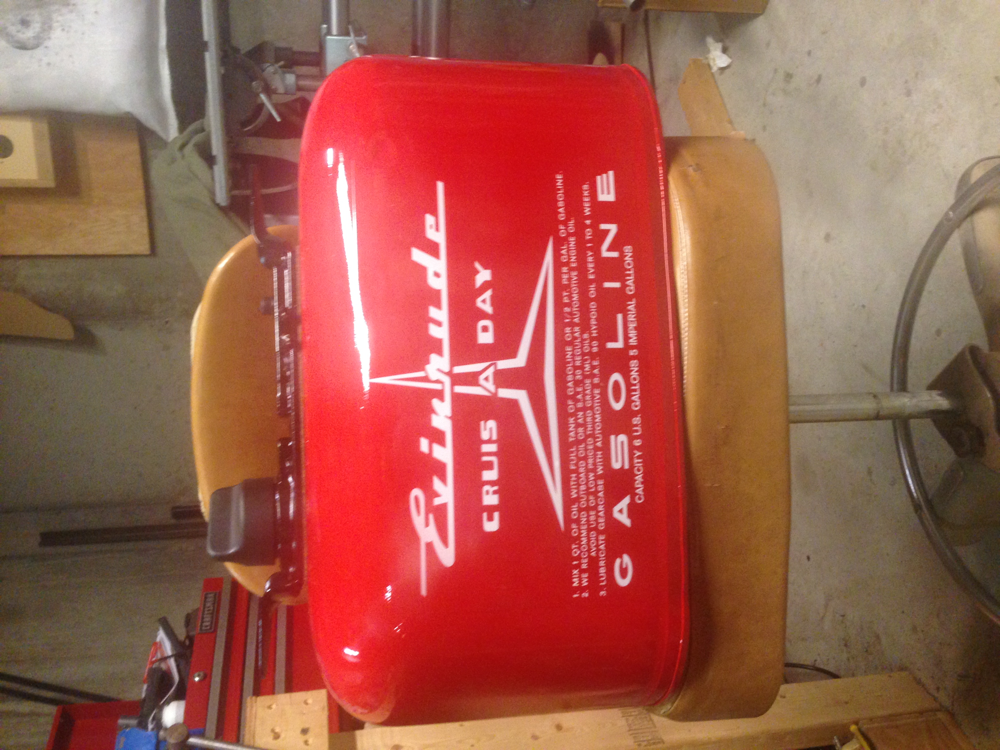

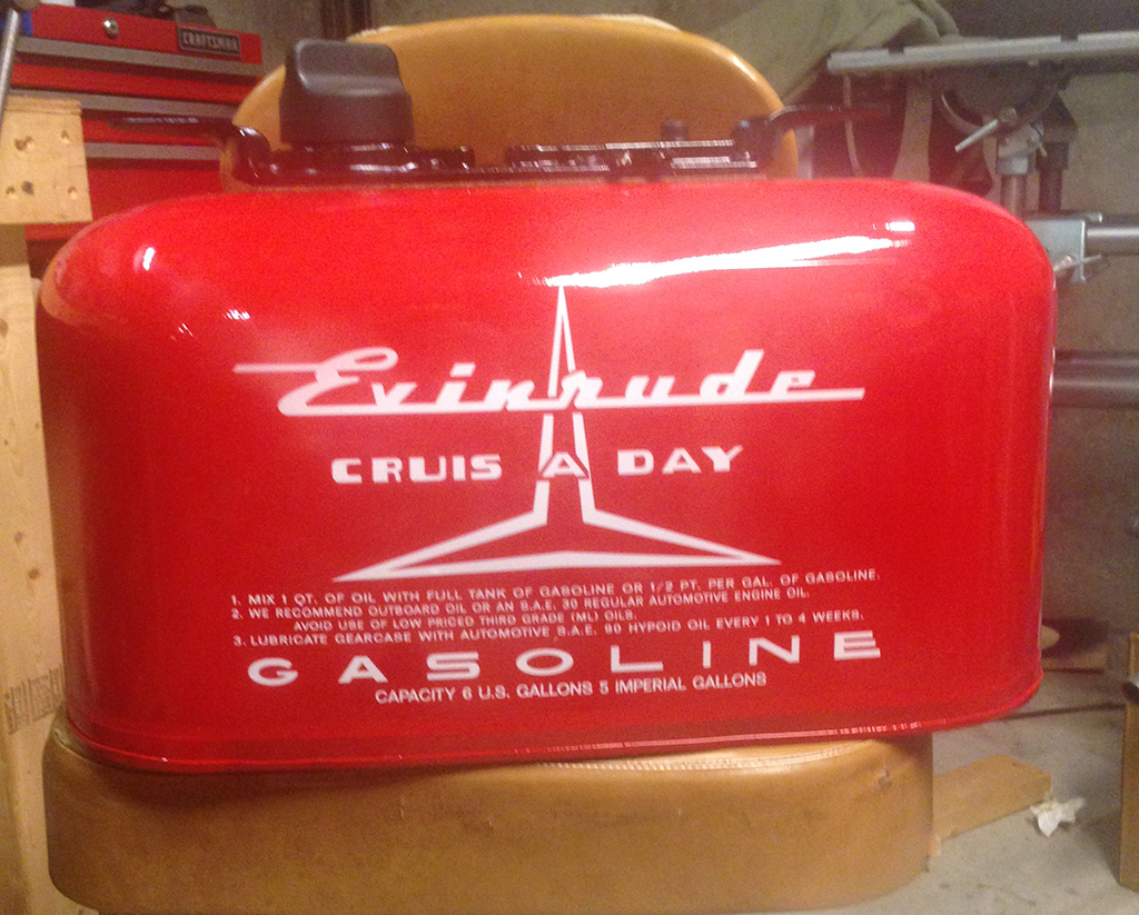

      I recently got a 1957 Fastwin with a tank. I finally got a chance to spray the clear coat over the decal. Got to finish the motor now.

        Great 1957 tank – looks like it was just shipped from the factory.
        #39102
        wedgie
          That looks great ! what paint did you use for the red?
          #39103
          david-bartlett
            Wedgie,
            I had a bunch of Valspar Tractor and Implement paint from Tractor Supply left over from another project so I used what I had on hand. Color is International Harvester Red in rattle cans.
            I sprayed the clear with some hardener with a gun after the paint cured for a couple weeks.

                When I did a couple tanks I found a rattle can clear with hardener, Spray Max 2K Glamour High Gloss Clear Coat 368 0061.
                It did quite a bit – a 3, 4 and 6 gallon tank and the top & side cowls on a Gale 25hp, with a little left over for other small parts.
                #39129
                  She’s a beauty Dave!
                  Vinyl decals?
