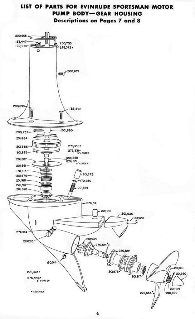

      Do these "pump plates" wear out or need to replaced often? Part 201887 I thought mine was warped but looking at the diagram, it seems like it needs to be slightly concave?
      #56964
        There should be no metal to metal contact in those pumps, so they should last forever. If you see worn spots, replace the 201934 thrust bearing. It is letting the drive shaft drop down too far. . . 😉
