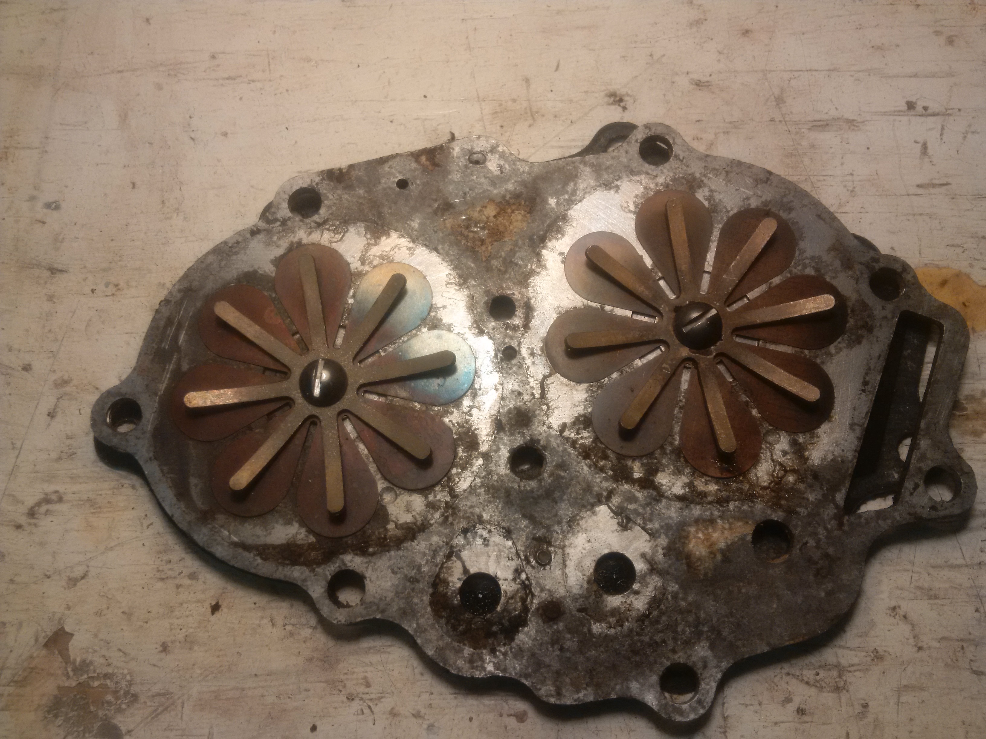

      What sealer to use on the intake /reed plate /manifold gaskets…. if anything ?
      #43081
        None. But doesn’t that thing look kind of gnarley?
        #43084
        beerman57
          You need to disassemble and use some scotch-brite pads on a Dremel or die grinder on the aluminum, and if that’s rust on the reeds, then clean or replace.

            quote FrankR:
            Yes, it was pretty gnarly, but I’ve cleaned it up since taking that picture. I’ll re assemble it sans sealer. Thanks
