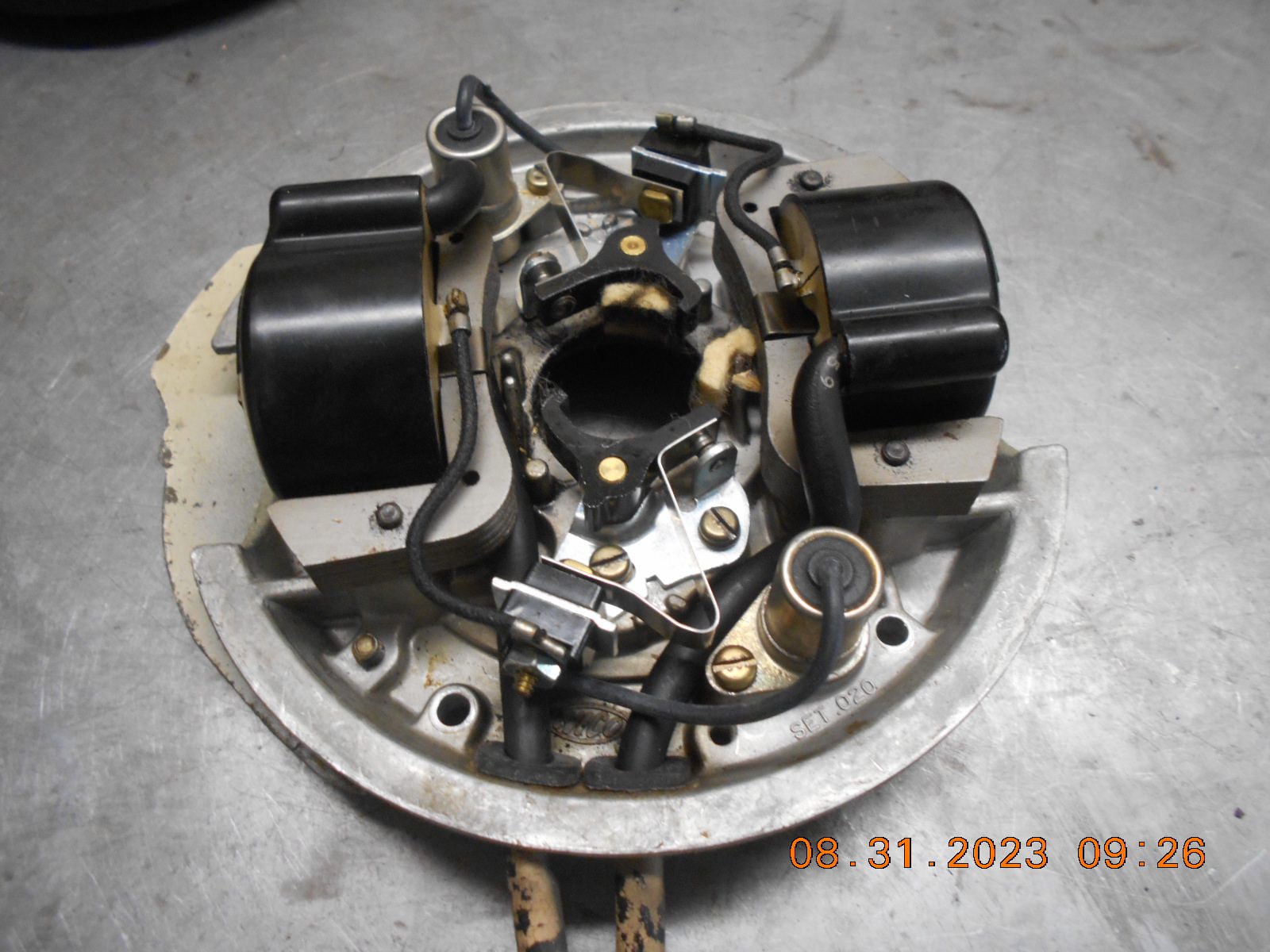

        This is the magneto from my 1959 12 hp.
        Is this like your mag?
        It may be possible to do a coil swap using OMC
        universal coils. Perhaps someone that’s done
        it on this magneto will chime in.

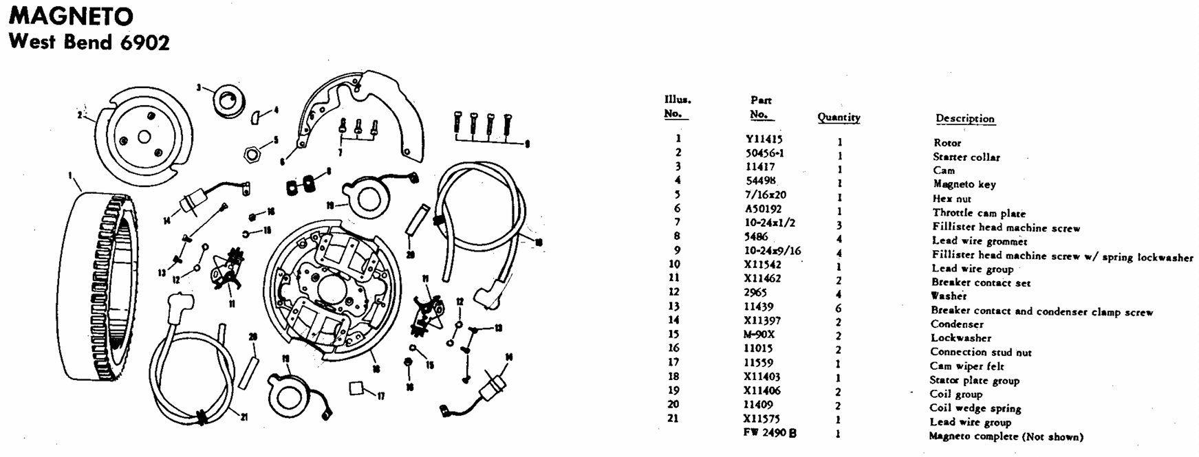

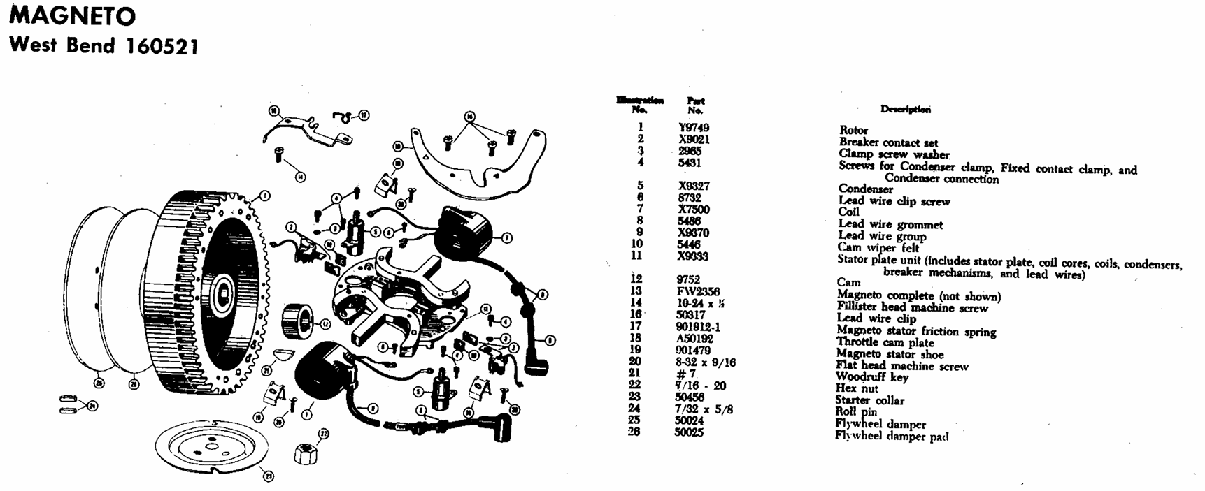

            Do either of these look familiar?
            wb6902
            wb160521

                no my plate is different.  coils are X7500 from parts manual.  stated as WICO, but later in paragraph mentioned as Fairbanks-Morse coils.
                #285157
                78bluestreak
                  the bottom diagram is close than the top.

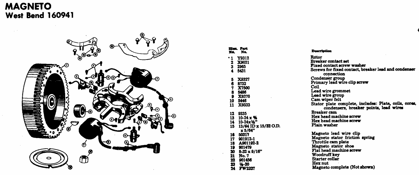

                    571.8901 is listed as a 1955 12hp, made by west bend.  Closest I can come is 1957 12hp west bend, model 160941.  Yep, X7500 coils.
                    wb160941
                    #285165
                      wb160941-1
