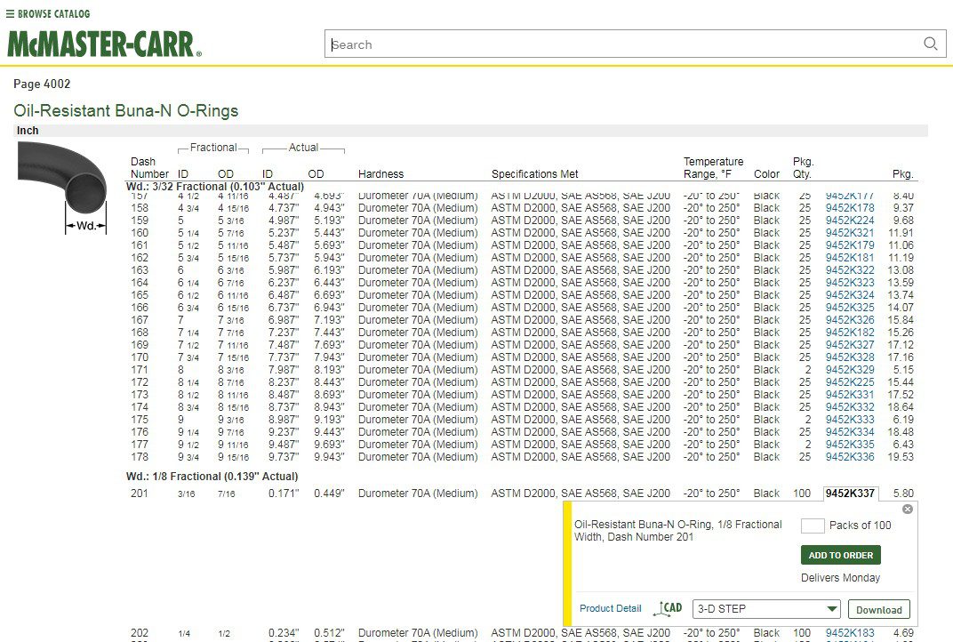

      I vaguely recall somebody on this site mentioning an O-ring as a replacement for the boss gasket.  Anyone have a part no or a source ?
      #288051
      Steve D
        McMaster-Carr part #9452K337  Buna-N 201 B  (Thanks Frank R.)
        https://www.mcmaster.com/catalog/130/4002/9452K337
        I use them all the time and they work great Oz. I have a bunch of them and can send you some if you want.
        201-B

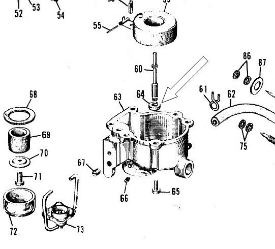

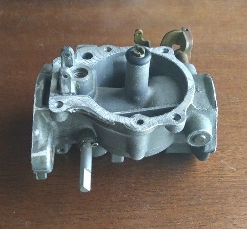

              Very curious:  what’s a “Boss gasket”?  Where are these o-rings used in the carb?
              #288062
              Steve D
                I figured he meant the gasket that goes around the high speed nozzle and sits atop the “boss” of the top 1/2 of the carb.
