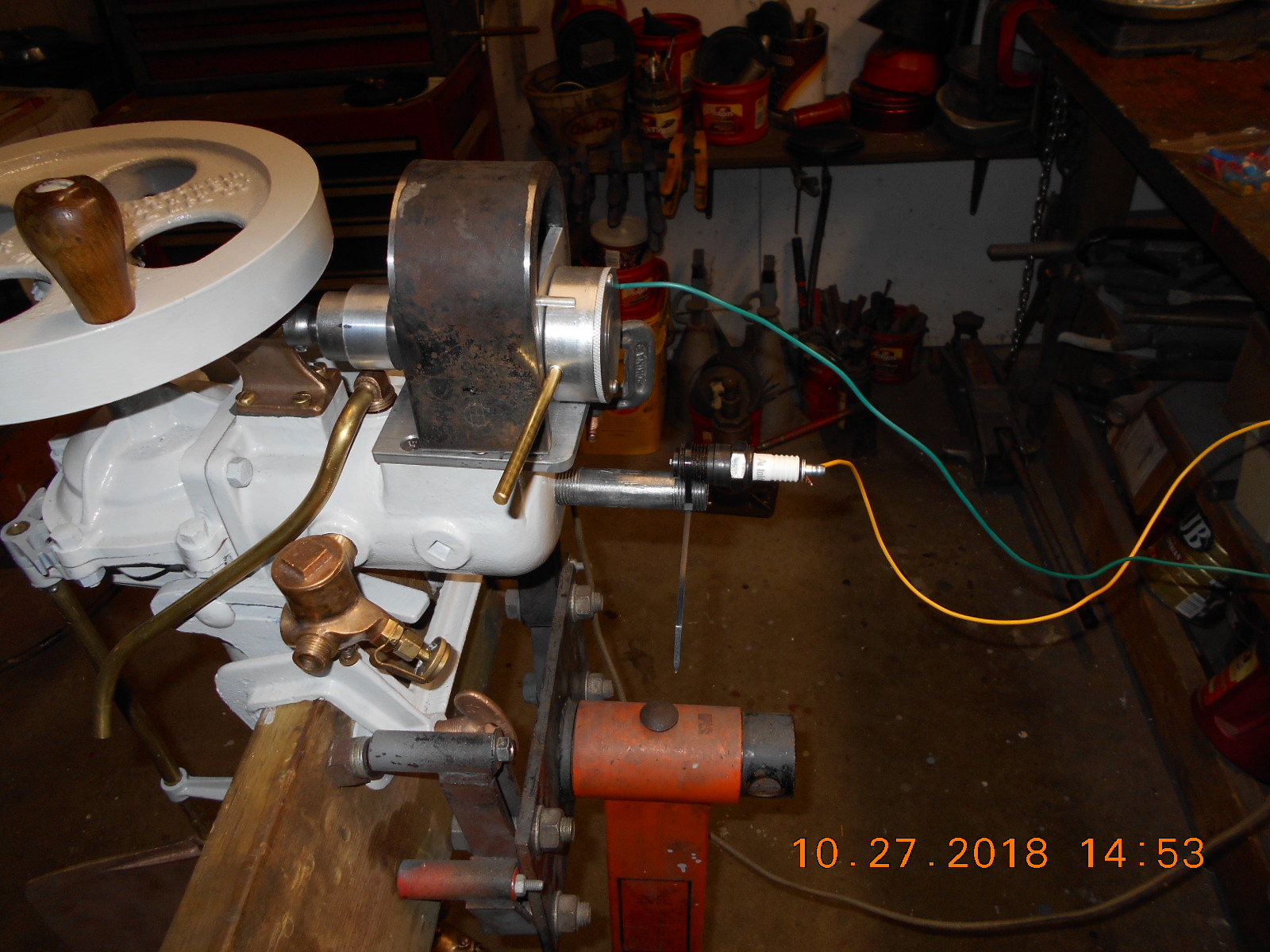

      Thanks for the replies regarding batteries.
      Regarding "setting" the timer for starting
      the motor, do I want it at TDC, or slightly
      retarded so it doesn’t kick-back and break my
      hand? 😮
      Thanks!
      #85013
      Tom
        I would start after TDC,maybe 20 degrees, and work backwards. My RBM fires at TDC when the timer handle is straight forward.
        T
        #85023
          Thanks Tom. It worked out that on my "center" detent, when
          the timer handle is horizontal, the motor will fire slightly
          after TDC.

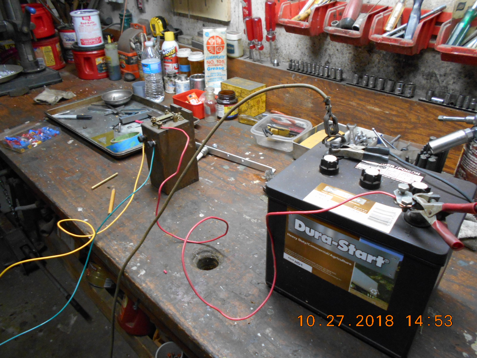

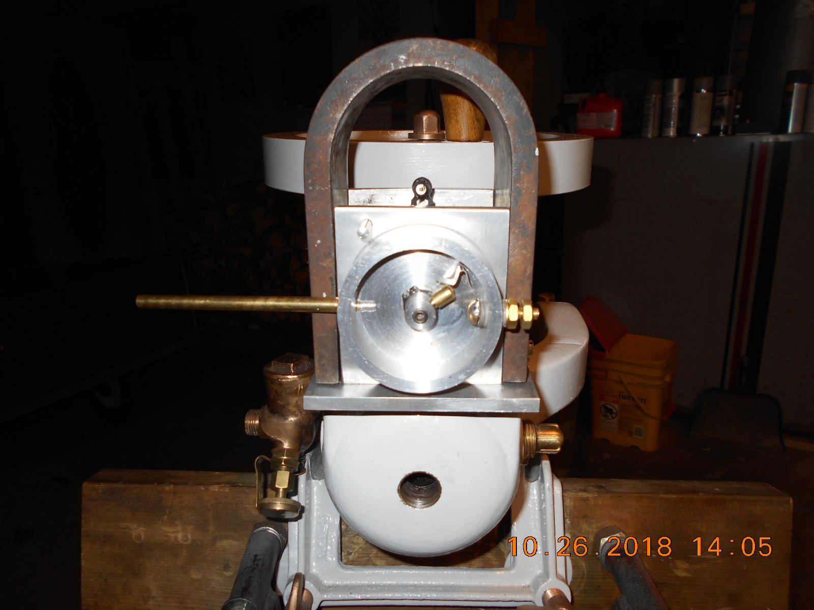

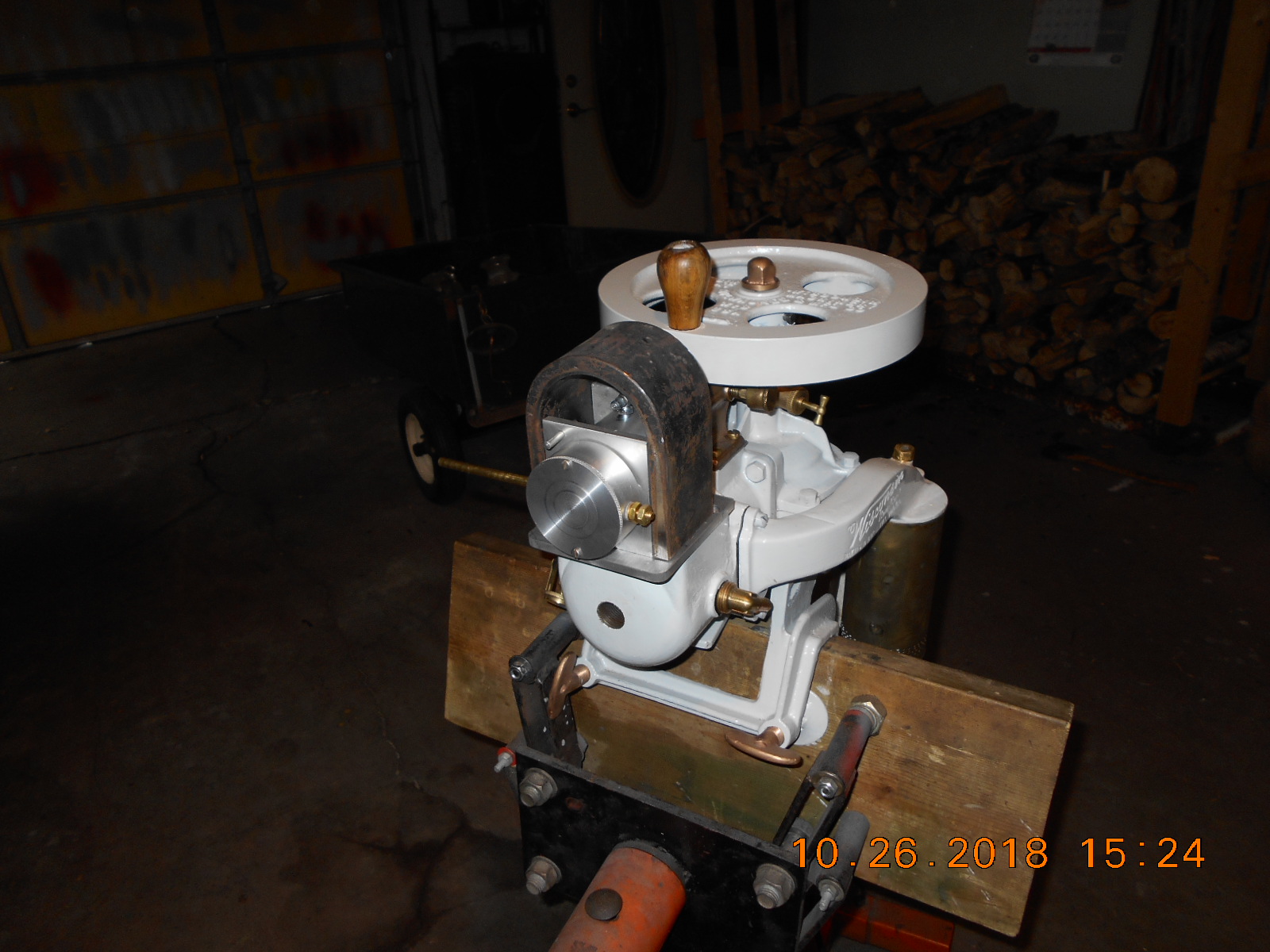

              I shortened the magnet to make it look better, and not
              stick up as high for cranking the flywheel, using a chop
              saw, bench grinder, and belt sander. Guess that was
              the easy part. Tried to drill a couple of holes in the
              side of the magnet for mounting it to the timer,
              but my drill bits wont touch it.
              What kind of super duper metal was that 1930’s
              magnet made of, and what kind of drill bit do I need?
              Thanks.
              Update- have not researched for a "magic" drill bit for
              the above problem, but did bench test the timer out
              this afternoon. Looks like it’s a "go" so far.
              https://youtu.be/XYq9cDvyoEs
