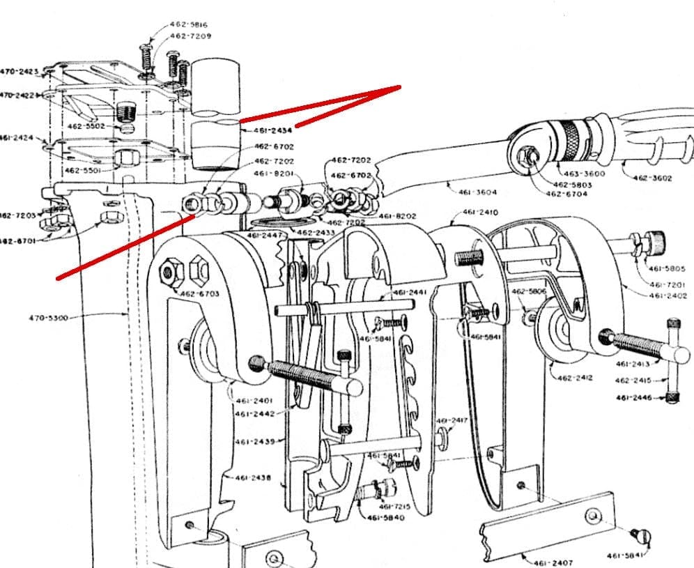

      I don’t know if I can help with that. If I ever had that part apart, it was ages ago. But near as I can tell, you first have to remove the powerhead, then the pinch bolt, then pull the pivot shaft up and out.
      Maybe this will help, I hope.
      SA-capture
