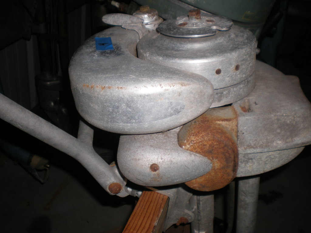

      Here’s another one that I need info on.
      It’s a Sea King, but I haven’t found a
      model number, and hence a year made.
      Ideas?

        Here is a link to possible years. It show 1936, 37, and 38 as opposed twins Seakings at 4.8hp and Thor as the supplier. (Im not sure if my assumption is correct)
        http://www.discount-marine-parts.com/ob_sea_king_1.html
        Here is you tube video of 1937 Seaking
        https://www.youtube.com/watch?v=D9PkFetgf-0

          Your searching went better than mine…. Thanks!
          I’d say mine is a dead ringer for the 1937 Sea King / Thor
          on Youtube.

            My guess is that it’s a 1939 5 horse made by Evinrude. The Sea Kings were sold as Vikings up here in Canada. The 39 was a model 466 (I think the Sea King was a 499?)
            Have a look at Richard Paquette’s site – there’s a good picture of the 466 in Viking colours:
            http://richardlpaquette.ca/mymotors.htm

              Buccaneer, can you supply additional pictures of the motor. A good snap shot on top of the rope sheave would help also.

                To the right of the carb there should be a welsh plug on the port cylinder. The model and serial number should be found there.

                  BTW – the model number should be on a brass frost plug on the block if it’s the Sea King made by Evinrude.

                    Sea King super twin 8811, 8.5hp. 1938-1941

                      Thanks for all the suggestions (or answers 🙂
                      I’ll bring it out in the light today and get some
                      more photos, and look for the said welch plug!
