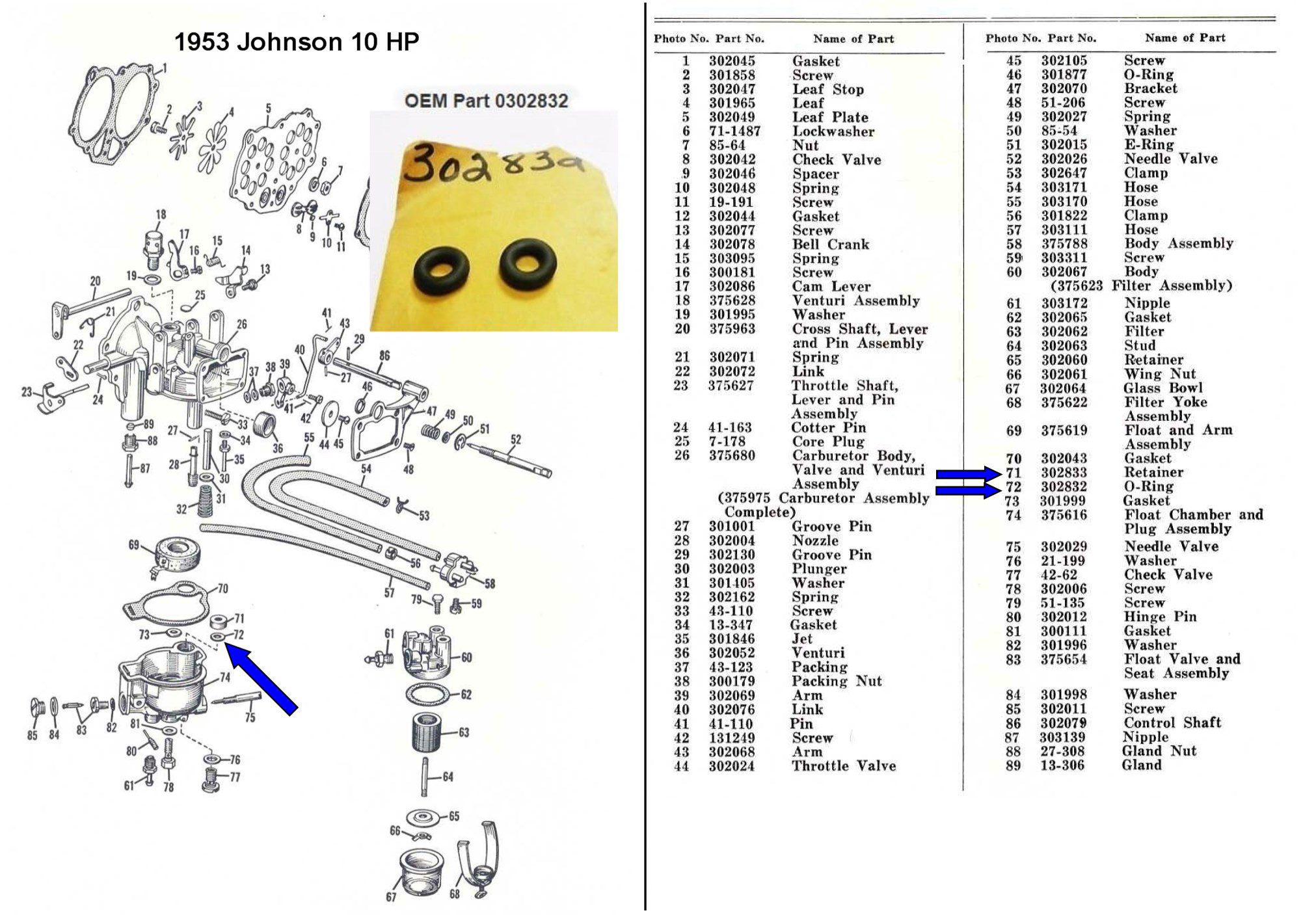

      I came across this seal 302000 on my shop clean up .It looks like a shift rod bushing but all my part numbers don’t match. Any help would be great. Thanks Ken
      IMG_0338

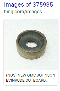

          302000 was superseded by 375935. But I haven’t been able to figure out what 375935 fits either.
          #252638
            Sure does look like a shift rod seal
            375935

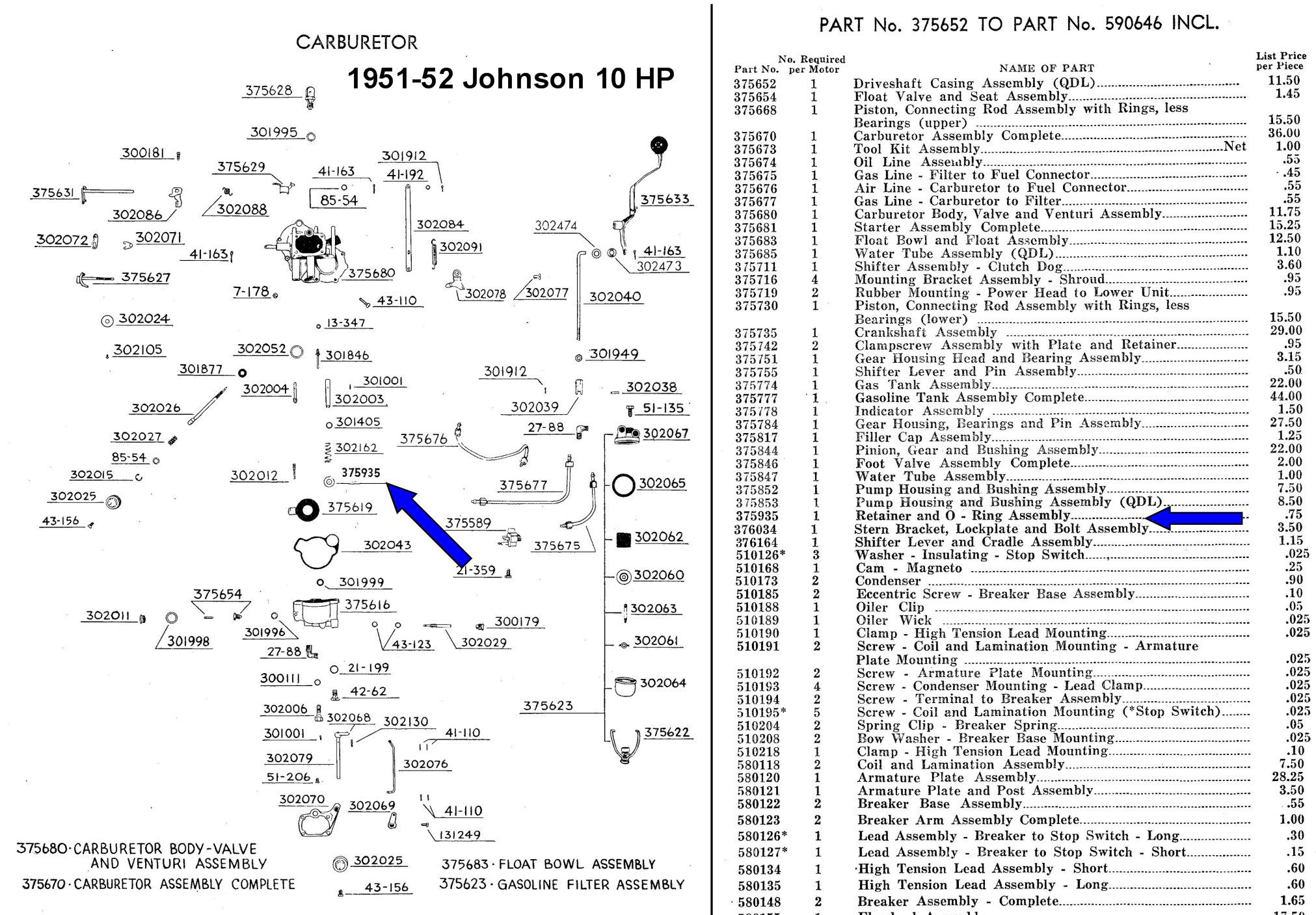

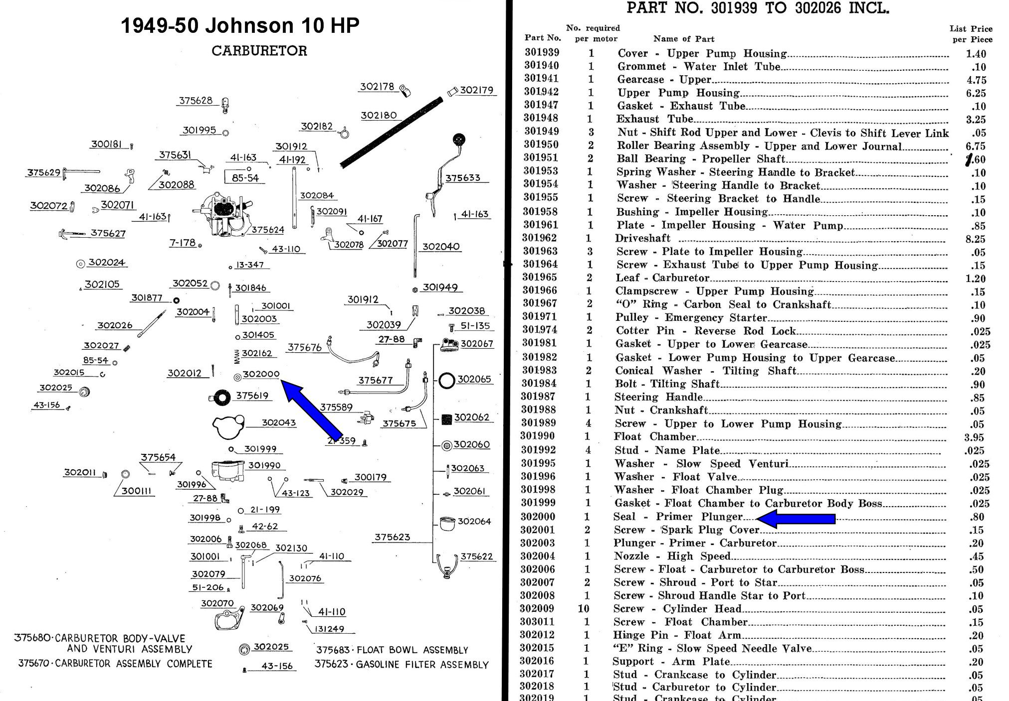

                In 1949-50 Johnson 10 HP that seal was used for the carb’s primer plunger. In ’51-’52 it was offered as an assembly of o-ring and retainer together as Frank’s picture shows, and then in ’53 the o-ring and retainer were listed separately.
                I haven’t been able to confirm it but I believe that fat o-ring is the same one as the extra one that’s included in many of the carb kits for the 50s motors, even though those carb kits don’t apply to those earlier years.
