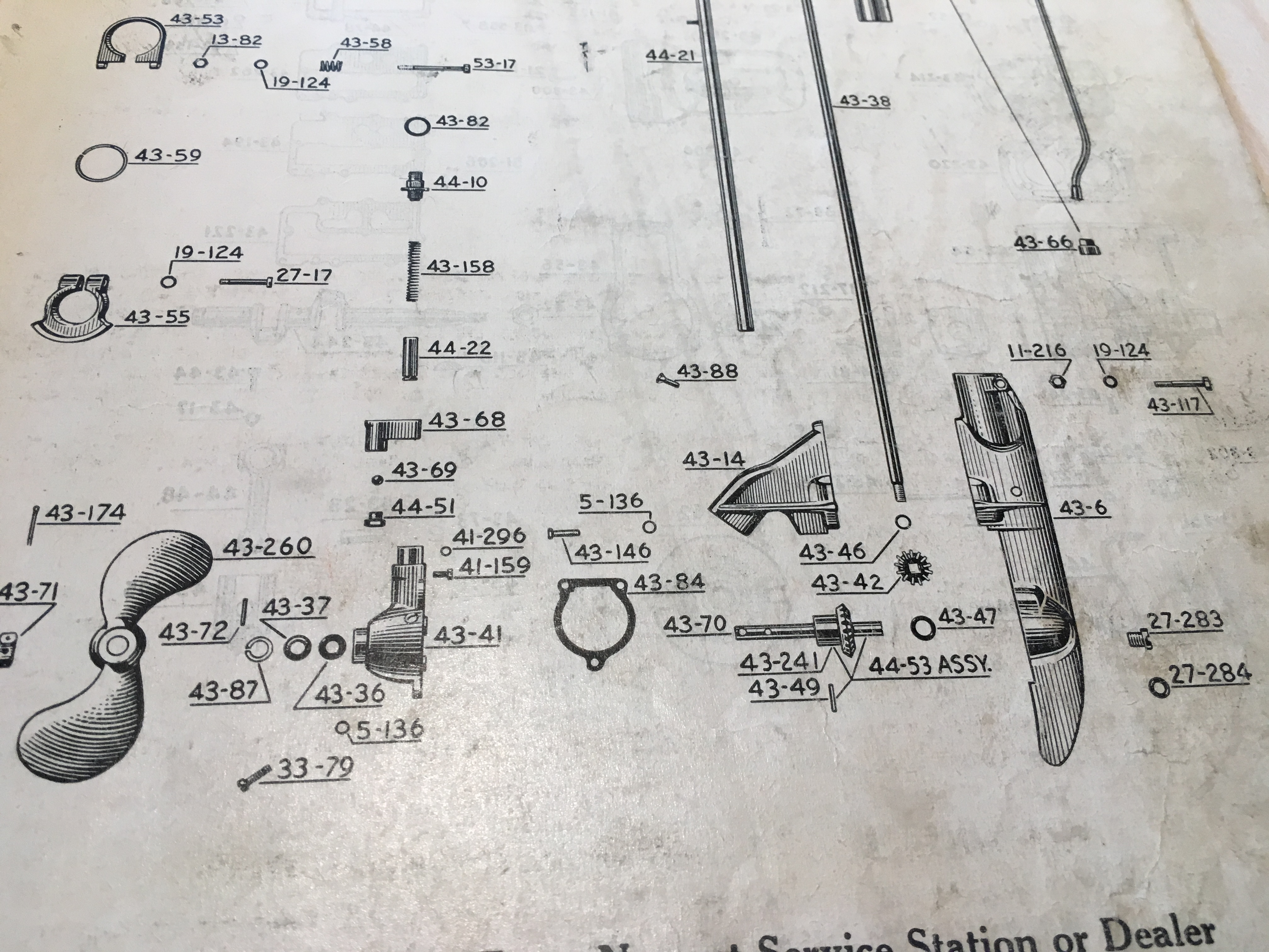

          #56761
          stanley
            Hope this helps
            #56763
              Much appreciated Stanley!
              #56764
                The parts list shows there’s a two piece prop shaft sealing system,
                part numbers….
                171244 "front"
                171245 "rear"
                Just out of curiosity, do those numbers supersede?
                I get no "hits" searching for them.
                Not sure what’s different between the two, but
                they seemed to be some kind of felt material
                that crumbled apart.
