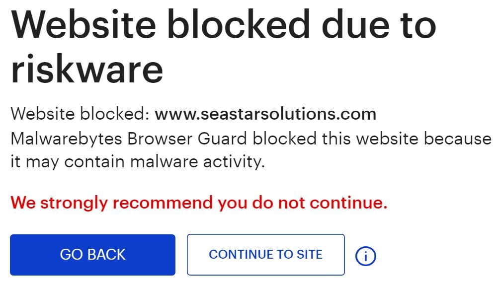

Hey Phil, my anti virus didn’t like that link you posted to Seastar.
Anyone else have this issue?
I just watched the video Mumbles….. no problems, nor warnings.

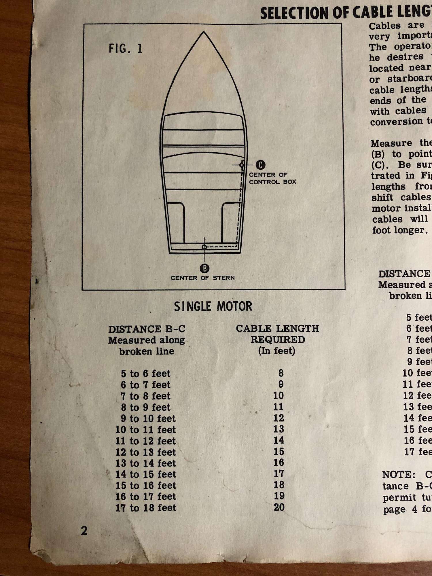

March 11, 2021 at 8:45 am #233516Scott, thanks for the instructions!
When I order cables, and say I come up with 16′ in my measurements, for example,
that will be the length of the outer cable, correct?
And the inner cable will be a foot or so longer?Prepare to be boarded!

March 11, 2021 at 10:07 am #233521Perhaps this was the link Mumbles was referring to, and not the video, regarding
potential disease of the harddrive. When I click on it, it get, “Blocked due to Riskware”,
whatever that is.Prepare to be boarded!
