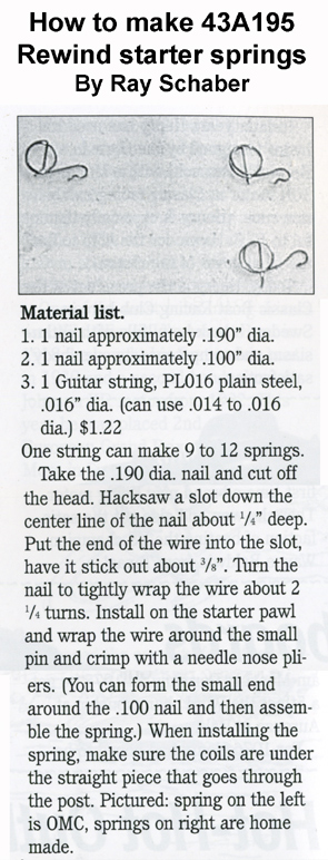

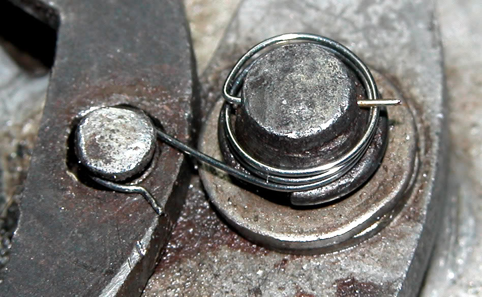

      I’ve been asked to post the instructions for making the starter pawl springs so here you go!

          I found wrapping them around a dremel collet worked well…
