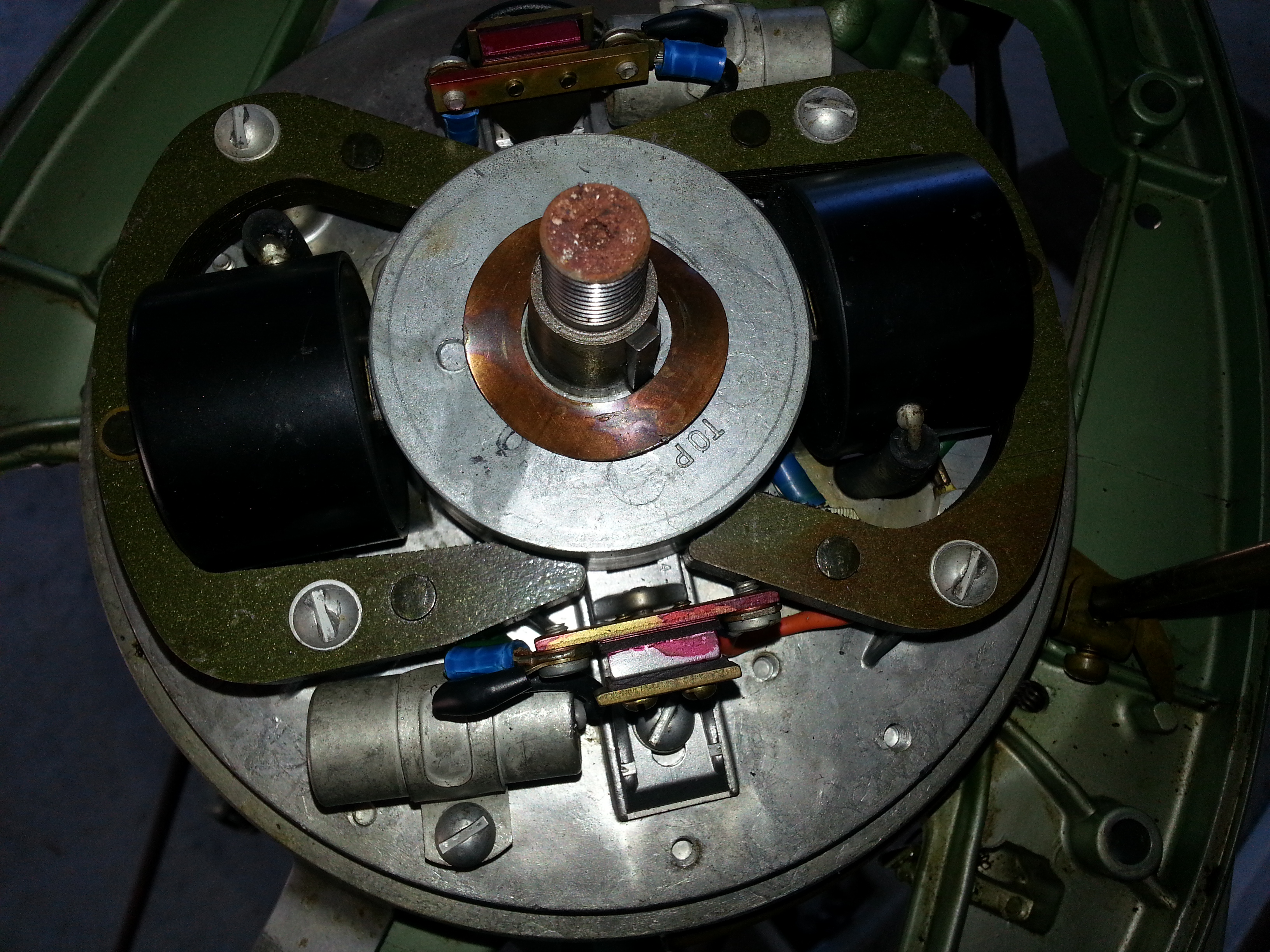

      Vikki…the coils and condensers are usually OK on these motors. The points require a very good cleaning. Be careful not to lose the little insulators.
      #39464
      shoestringmariner

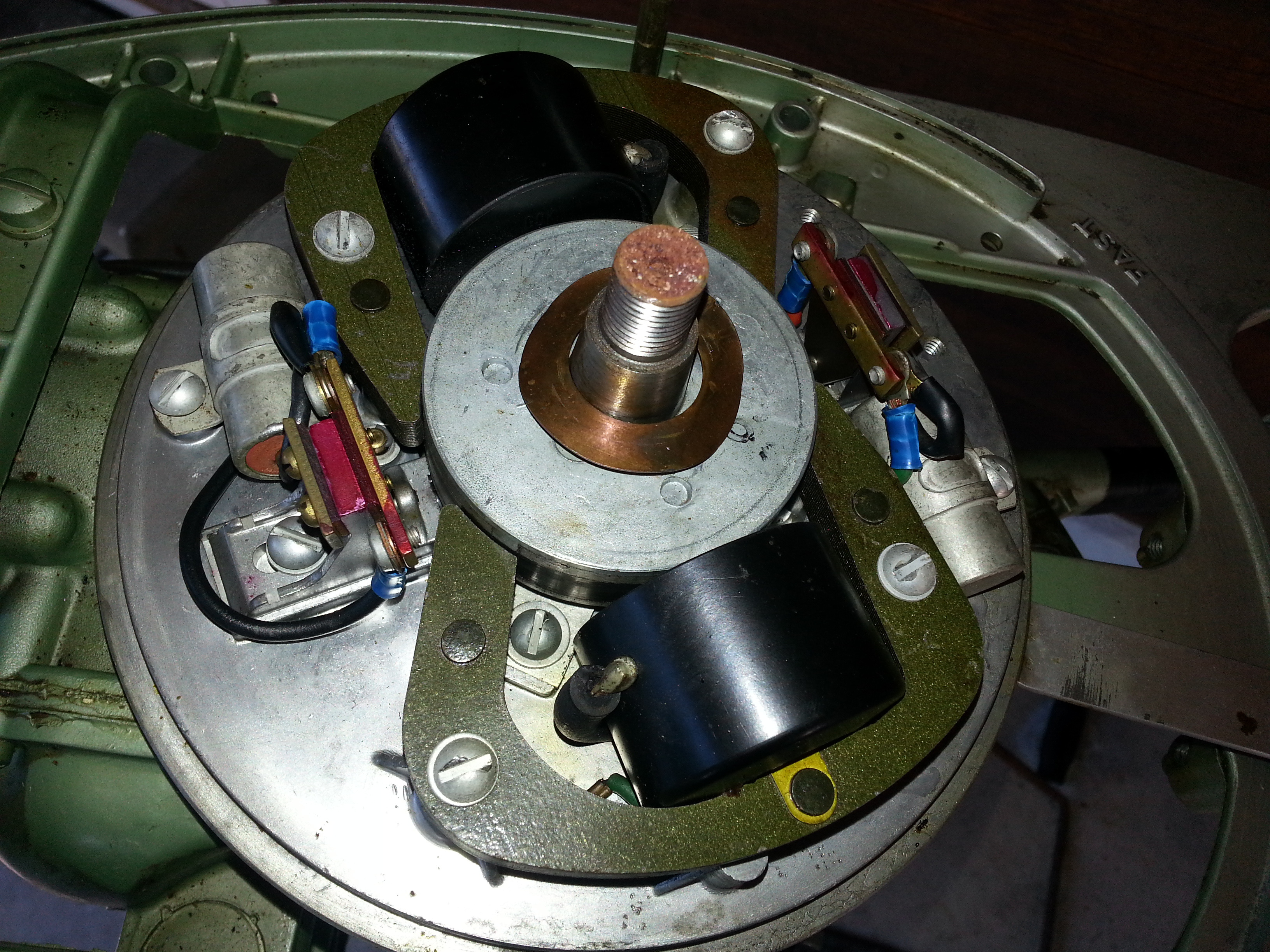

        If coils are original, they will be dry rotted and crumbled. Standard coils, should be able to get almost anywhere or Napa
        #39466
        vikkip
          Super clean ignition!

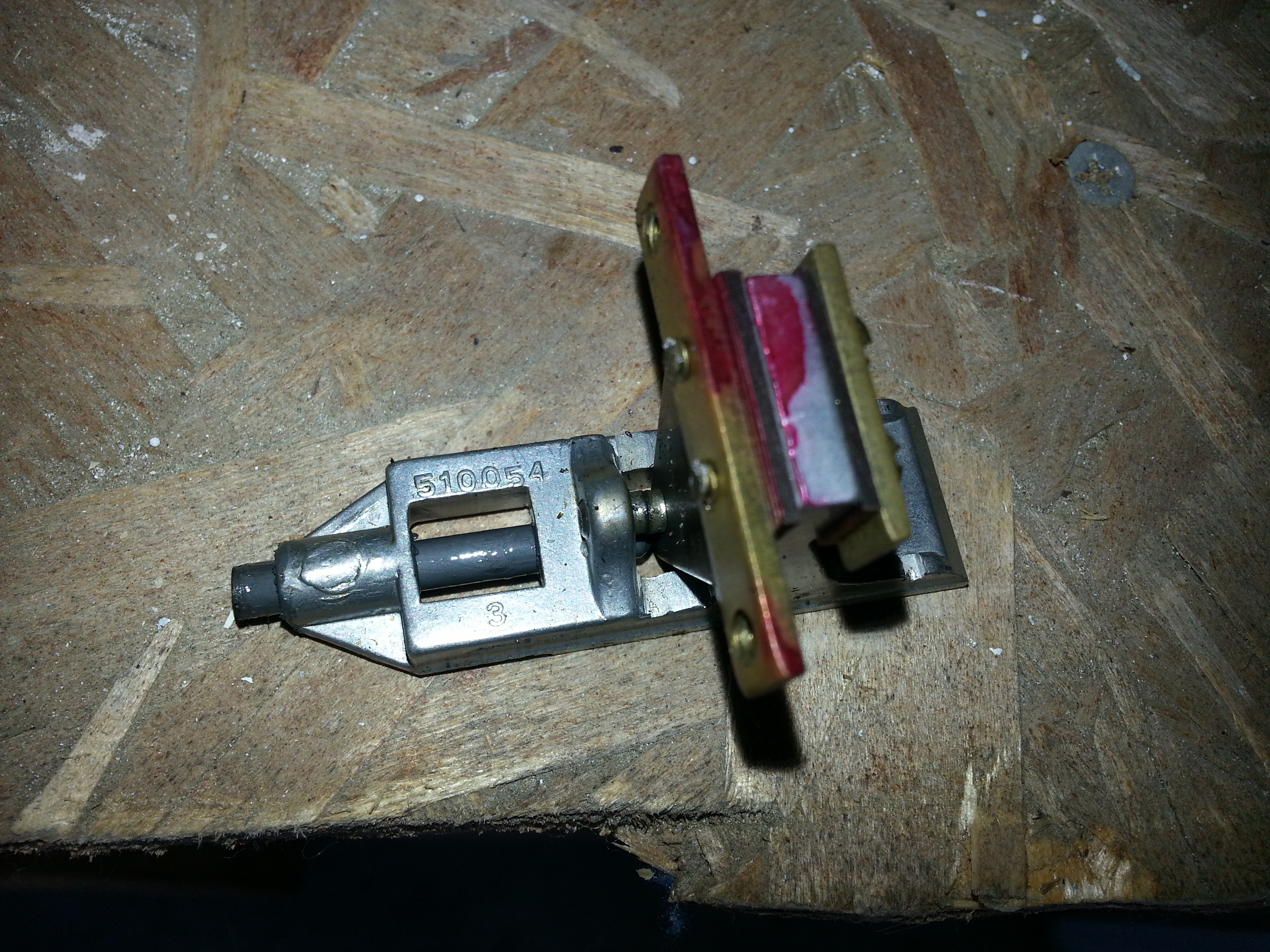

          Points have perfectly flat contact surfaces. I’m cleaning and dressing them anyhow. The point plungers are still covered in gray grease that has the consistency of lithium grease.

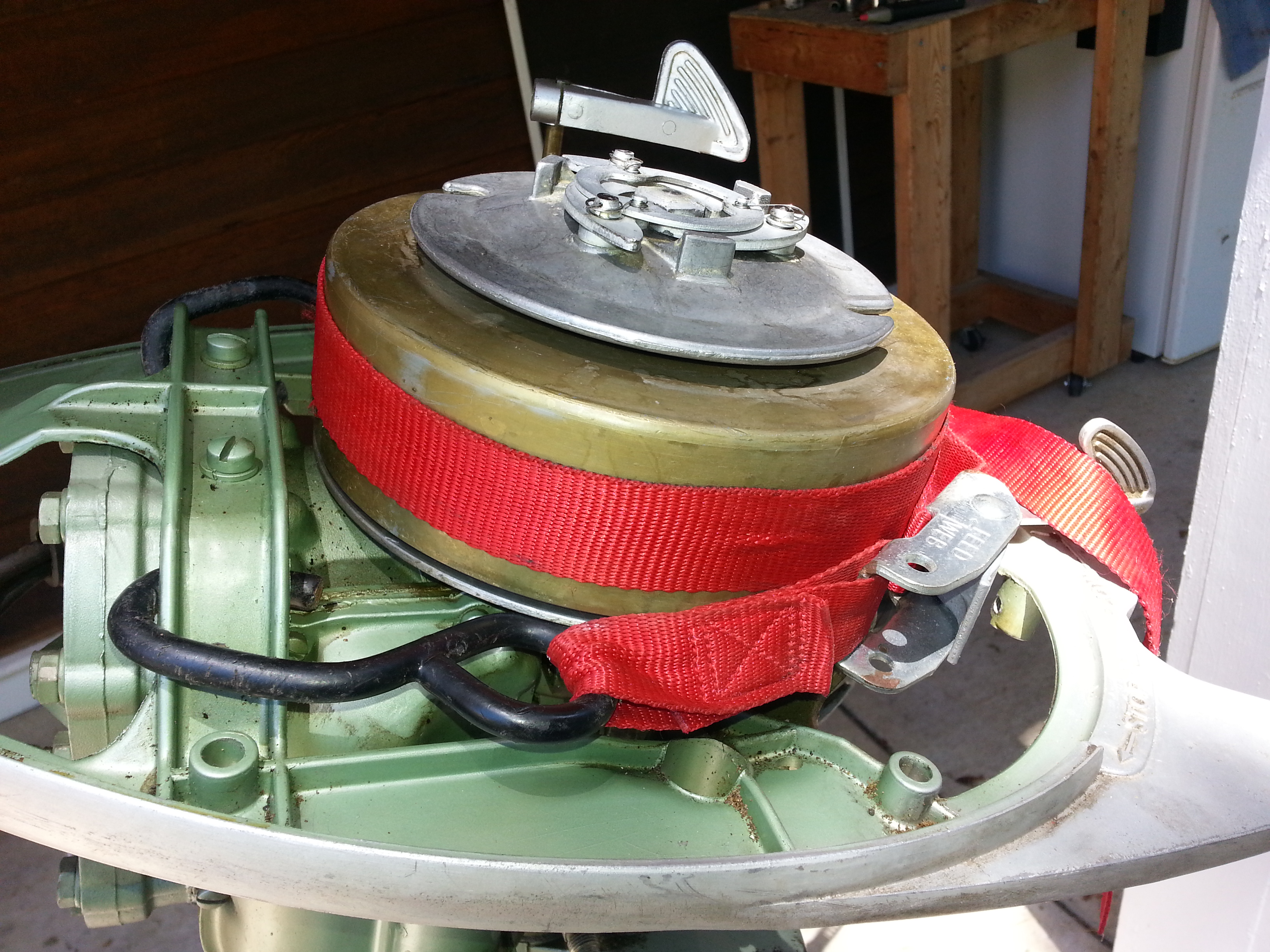

              My strap wrench wasn’t big enough to wrap around the flywheel so I had to improvise.

                  I think it was Frank that said (I’m paraphrasing) "those coils were made before OMC figured out how to make them last for only 5 years."
                  #39484
                  steveh
                    ShoestringMariner, the coils in these motors are usually good. Later OMC coils didn’t hold up as well.

                        The good news is you have the older style coils that tend to stay good, the bad news is, they are NLA in the universe…..new, that is..
