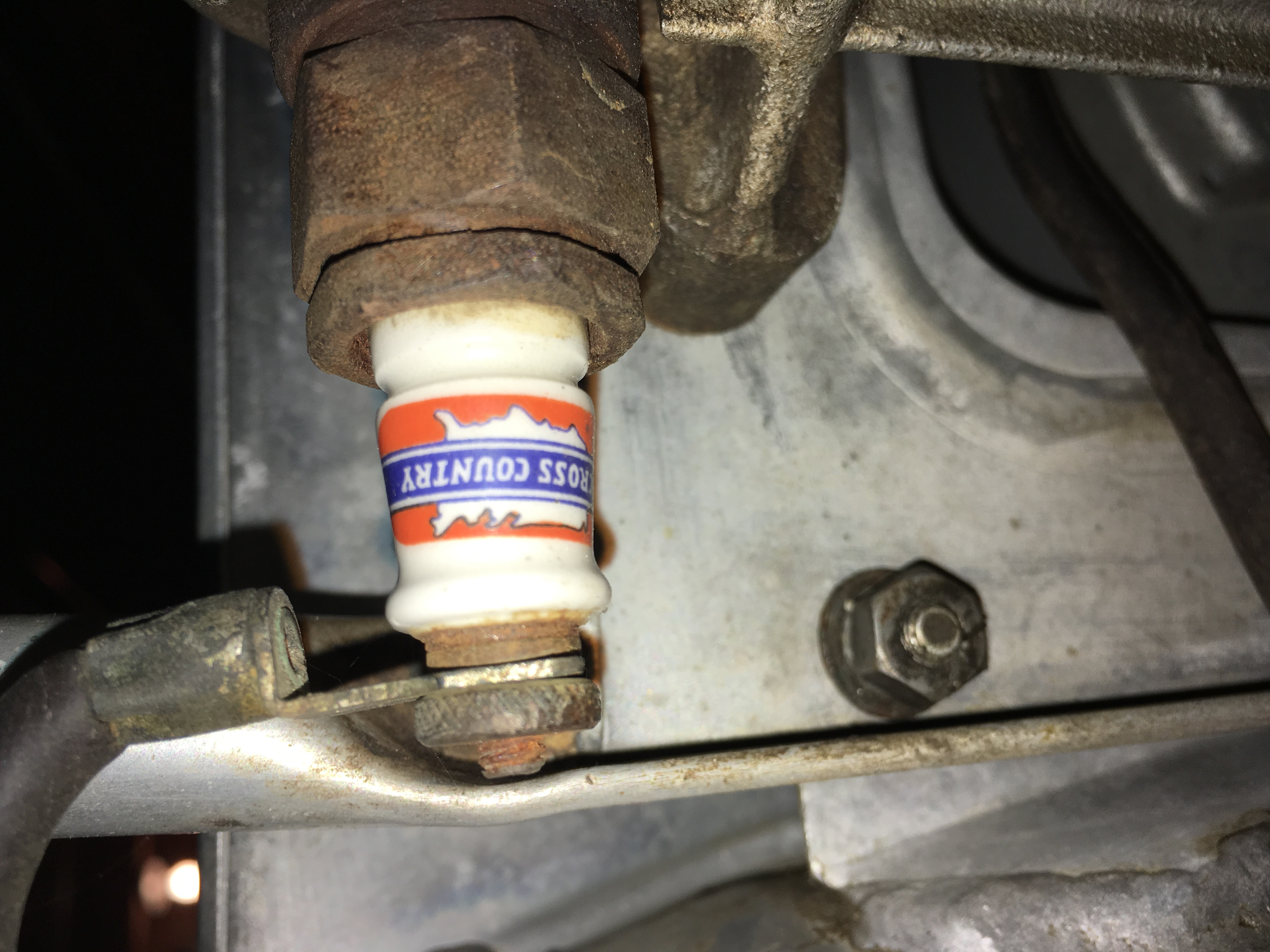

            The period correct plug would be a Sears Cross Country

              Tubs,
              I second that!

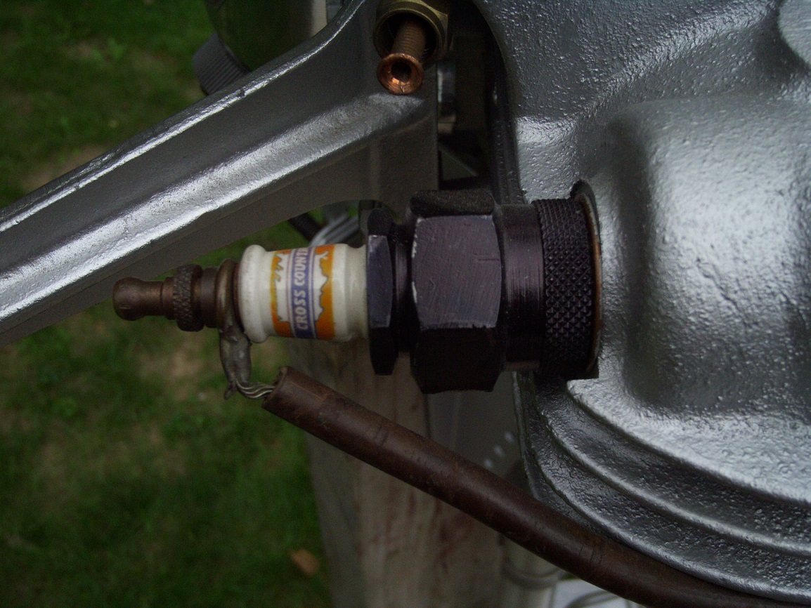

                Per Peter Hunn’s book "The Old Outboard" a Champion C-7 spark plug can also be used.
                Modern Champion D16 or AC C86 also can be used.
                I have a Sears Cross Country plug for sale if you need one.
