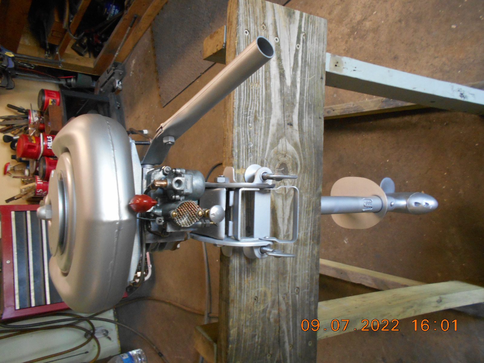

        No diagrams here, but is there anything particular you’re trying
        to figure out?
        I have a 1945 3 hp that I went through, and I’m guessing it’s
        very similar to yours.
        DSCN4643

            You don’t say what year or model your motor is, but if built like mine,
            it has a very different water pump. I can’t find photos showing I actually
            took the pump apart, but I believe it’s similar to some of the little Elgin
            outboards with the “carbon, sliding vane” affair.
            This is the water pump, and if I remember correctly, I had some trouble
            removing it from the driveshaft tube.
