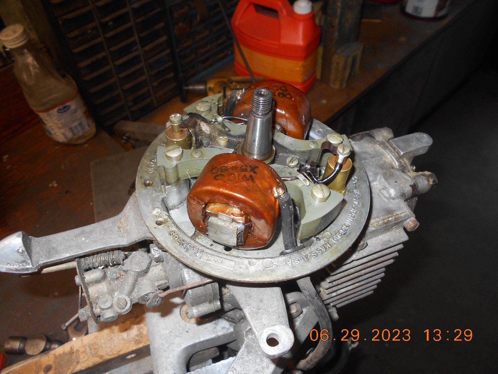

      Got this parts motor in a mass purchase years ago,
      and I cataloged it as “motor #38”, but evidently
      never ID’d it at the time.
      It’s looks like some type of Tillotson AJ carb, reminiscent
      of some old Mercs with the slide-gate choke.
      It’s missing the transom mount, gas tank, cowlings, etc.
      No spark when I pulled it over, but the coils look nice,
      and the secondaries ohm out good.
      Only 47 and 55 psi compression, but I found two rings stuck
      on one piston, and one on the other.
      DSCN7269
      DSCN7271
      It has a cam on the base of the mag plate that
      I don’t remember ever seeing before, and
      as well as the throttle arm that rides on it.
      DSCN7275
      DSCN7276

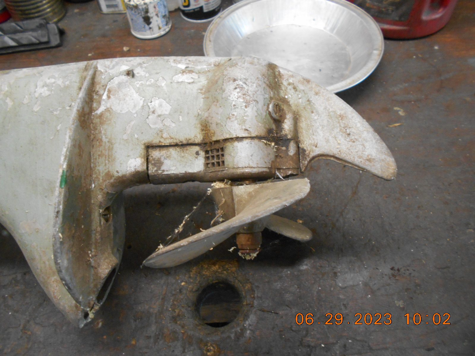

      #277592
        More clues?
        DSCN7270-1
        DSCN7271
        DSCN7274

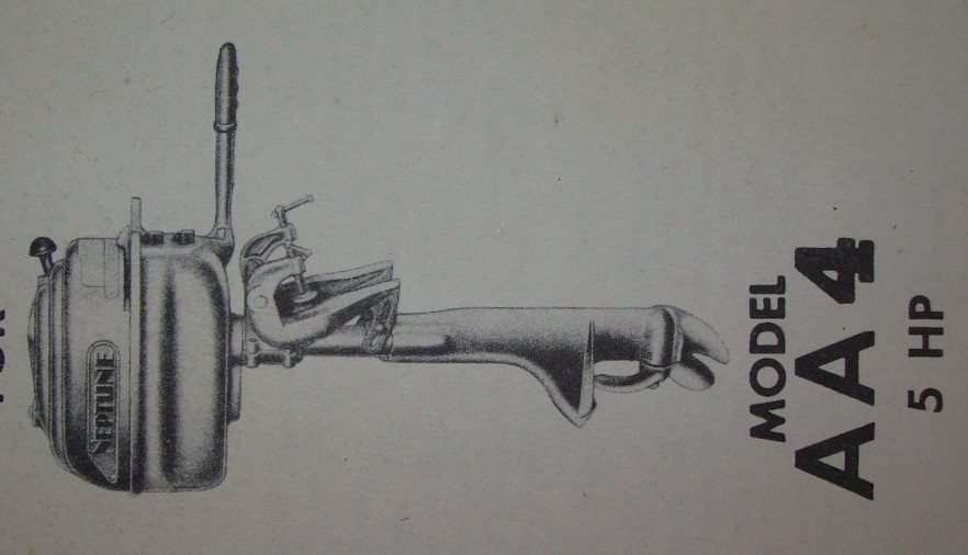

          Guess… Neptune of some kind??  the “push plate” choke is reminiscent of some motor , 3.6 Scott maybe ?
          Not much help !
          Joe B
          #277607
          HARRY D. NICHOLSON
            That looks like a later Neptune such as this light green 1948 5HP Model AA4. If so, the Tillotson carb should be stamped AJ24A Neptune1948AA4model008
            #277609
              From my Muncie – Neptune picture files.
              Listed as a SKIPPER BB-4 1950 5 HP. ????

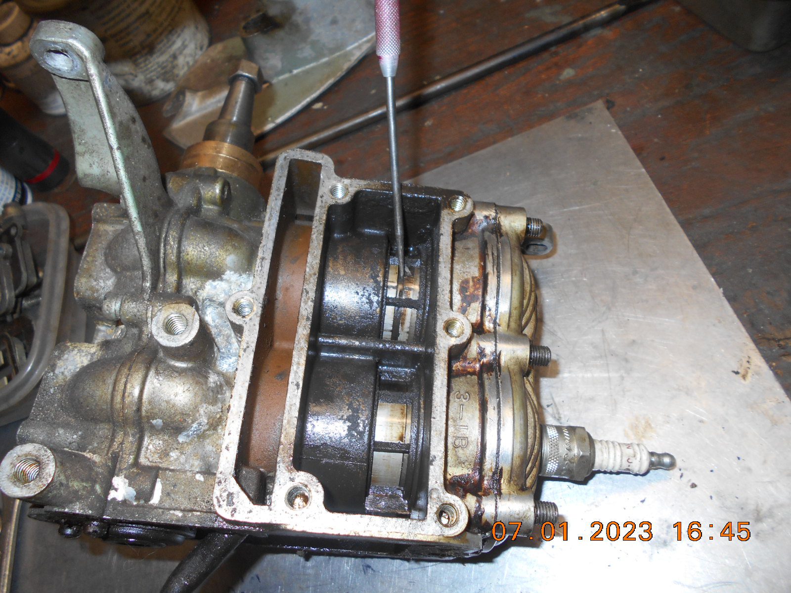

                Anyone have B X S specs for the 3.5, and 5 hp Neptune’s for 1948  – 50?
                I got a rough bore measurement through the exhaust port of 1.763 ish inches.
                May be handy to know which parts motor I have in case someone needs
                parts, or I see a Neptune of the same vintage.
                Found out the low compression on the top cylinder was because the
                upper piston coughed up part of a ring, but lots of good parts anyway.
