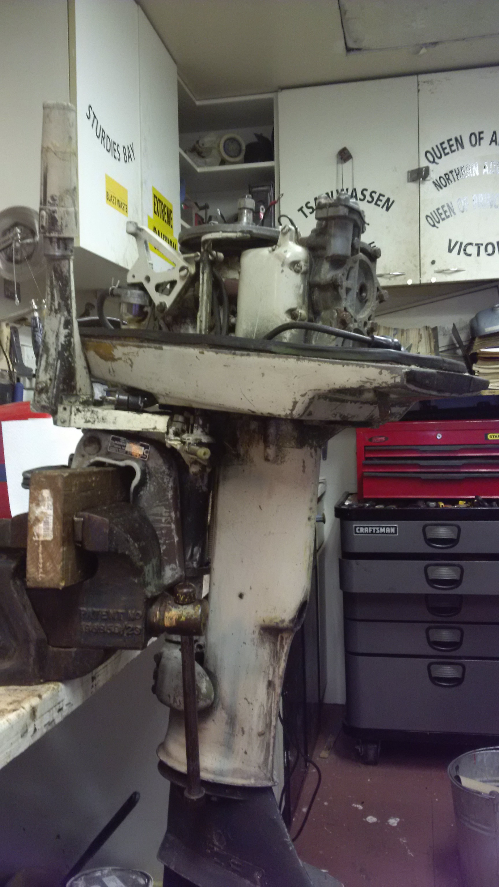

              This ’63 QD looks really bad cosmetically and is missing bits, but I think it will run ok with even 75 psi on top and bottom. Luckily I have a flywheel and recoil from a basket case motor.
